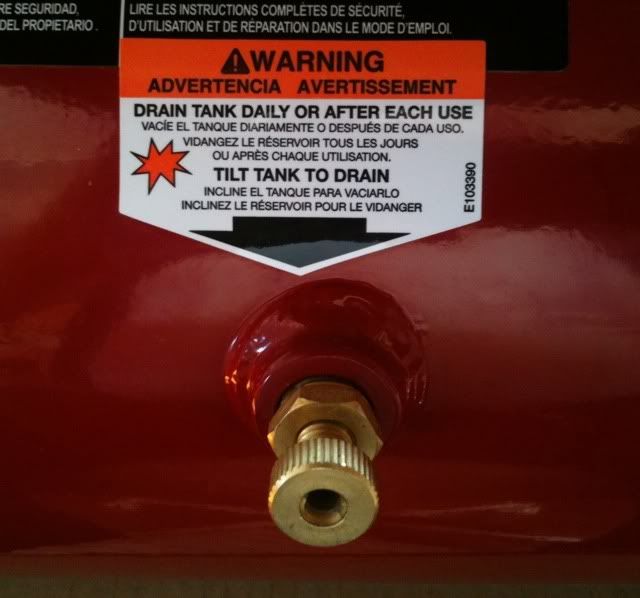

PROBLEM #2 - MOISTURE
Here in Ohio it is quite humid even like now at 22 degree F and overcast, the airport reports 85% humidity. Without snow or rain clouds the humidity would drop like a rock and become a dehydration problem in these freezing temperatures. Here in Ohio, humidity is always a pending problem.
Reading the Instruction Manual "MAINTENANCE" Section, it states that the Compressor "must be shut down, air pressure released, and the tank drained of moisture at the end of every workday" to prevent corrosion from water accumulation in the tank. If used outdoors in cold climate it must be similarly shut down and drained at the end of each use.
Wow, I'm going to have a problem getting used to draining the air and the water out of the tank every time I use it. I suppose if I want this thing to work safely for a long time, I have to waste at least 1 tank of air for every day that I use the Compressor. Gee, I just got it to hold air more than overnight and now I have to unplug it, release the air, and drain the moisture out of the tank before the job is done. Isn't that like turning the other cheek?

Oh yeah air compressors. One thing different from the job site and your situation is during a day on the job site the compressor will turn on every three to five minutes or more. Basically it's like running it all day long. Even after running it all day long there is maybe a quarter cup of water in a high humidity environment like Portland, OR.
You can drain the tank while the compressor is running without much problem, it certainly won't wreck or wear anything out.
You'll get a feel for how much moisture develops and it won't be the end of the world if it's not emptied everyday.
You may be able to get an inline moisture trap and plumb it between the compressor and the tanks, you should have one before the shoebox for sure, many have a clear cup so you can see how much moisture is in there and the end will have a similar twist thingy to empty it like the tanks do on the compressor.
Be careful with that teflon tape to not get it into the airline. It can clog things if the line or holes down the line are small and a piece of tape dislodges.
Also there is a bit of an art to wrapping the teflon tape, you want to be sure to wrap it so it tightens around the threads when you tighten the fitting. If you wrap it backwards the tape will loosen when you screw the fitting onto the threads.
Also the quick connect fittings have a habit of leaking after they are used. Job site nail guns are always leaking from the quick connect fittings, another reason why the compressor kicks on every few minutes.
Oh and usually the exit air is pulled off the top of the tank and the water will settle on the bottom, I had a Hatachi side tank that had two tanks (one atop the other) and you could practically fill the lower tank with water and the airline from the top would be bone dry.

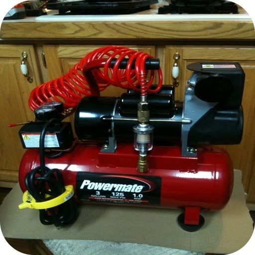

Synopsis, good info. I pushed some Teflon away from the tubing and trimmed it where necessary. I thought loose strands could wreck a connection.
Here's a picture of the Lady In Waiting. Waiting for her ShoeBox Compressor mata:

Postby synopsys » Tue Jan 11, 2011 7:30 pm
She's a purdy little thing!
Perfect size for my bedroom shop! :lol:
What's it like 12" wide with the feet? :shock:

Postby LURKER #1 » Tue Jan 11, 2011 10:50 pm
Synopsis,
She's less than 8.5" wide at the feet and add 1 more inch for the ventilated pump outlet tube and connection to the side of the tank and the hose quick disconnect that sticks out maybe the same inch. About 18" long by 19" high. The way it is in the picture with hose and added water/oil trap she weighs 37.8 pounds. Any heavier might require wheels.

I drain my "shop air" compressor once a year, whether it needs it or not. I had never heard of draining the tank until one of my friends told me that it needed to be drained after each use. :shock: Hmm. So, four, or five years after I bought my compressor, I opened the valve and some rusty water came out, but not as much as I was led to believe. Maybe it's because I live here in L.A.? Mine is a 33 gallon, twin cylinder, 5hp, 220 unit that definitely uses oil. I really like my compressor.
My friend has had his oil less compressor for twelve years and has had really good luck with it. I was expecting it to suffer diaphram failure. It has proved to be a better design than I thought it would be.
Oh hey, it's January, time to drain the tank again. :wink:
